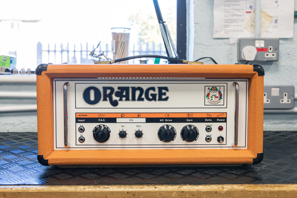

Over the past month, we’ve been taking care of an original Orange OR120 head from 1974 that was sent in by its owner for a tune-up before being passed down to their son. In the previous entries, we’ve had a look at the unit’s history and legacy, as well as how we’ve fixed it up for use in the modern age. Now, it’s time for the ultimate proof of the pudding — plugging in a guitar. All guitar sound samples in this post were recorded on a PJD Carey guitar with a single-coil pickup at the neck and humbucker pickup at the bridge.

How the amp achieves this volume is mainly down to the huge 500 V voltage in its circuit, which is far greater than modern amps and will offer miles more clean headroom. Four power valves and a simple pre-amp circuit that doesn’t subtract too much gain from the signal also helps. There are also fewer tone stacks in the OR120 than a lot of its successors in the Orange range, which would account for less gain loss through the signal chain.
The amp’s tone is also an interesting indicator of its age. With all dials set to the middle, it’s remarkably clean and chiming, with plenty of heft and three-dimensionality, if not quite the character of Orange amps of the new millennium.
TONE-SHAPING
However, the unusual F.A.C. control, a six-point notched dial that subtracts increasing amounts of low end from the tone, has a huge impact in shaping the tone, making the sound increasingly brittle and bright as it’s introduced. At its farthest extreme, this sounds piercingly trebly to modern ears, but revisiting the records of the second half of the 60s and early 70s by the likes of the Beatles and the Byrds, for example, reveal this to be the sound of contemporary guitar music, suggesting Orange to be on the cutting edge, as ever.
When the F.A.C. is combined with higher gain and into overdrive territory, however, it adds a definition to the tone that counterbalances the slightly muddiness of the basic overdriven sound, and proves to be an invaluable component of the amp’s tone-shaping toolbox.
The two-band EQ is also surprisingly powerful, with the range of both knobs allowing considerable variety to the shape of the sound and consequent versatility, presumably another feature included with the idea of helping the guitarist onstage with a noisy band around him. Similarly, the HF. Gain knob has slightly more subtle control, moulding the mid–high tones in much the same way as a modern-day presence control would, but its interaction with the gain knob is still well incorporated.
OVERDRIVE
Another interesting sign of the times, tonally, comes in the form of the OR120’s only modest overdrive capabilities: the amp’s noticeably clean chime only starts to break up as the gain is pushed up beyond about three-quarters, and there’s a lot of “edge-of-breakup” territory where the tone’s fuzz is largely dictated by the player’s technique. Furthermore, the absence of a master volume knob means that you have to be playing through the amp at an exceptionally loud volume before any semblance of break-up or overdrive emerges. Even at full gain, though, it’s a long way from the fully saturated tube screamers of the 1990s and beyond, and retains more of a British punk/Sex Pistols sound, with grit and ferocity, but also quite crisp (although whether the likes of the Steve Jones, who famously stole his early instruments, ever got his mitts on an OR120, is a moot point).
