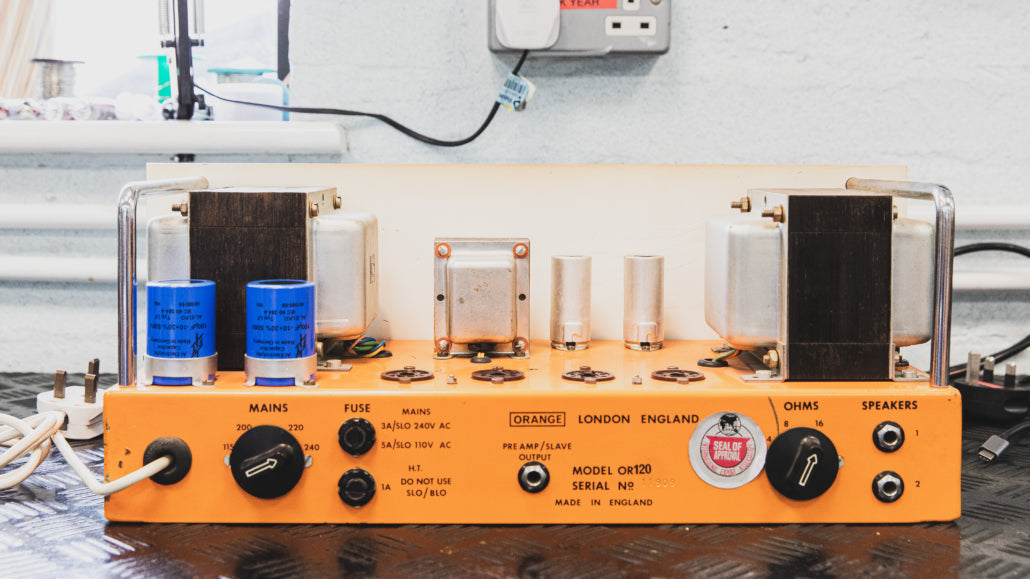

The other main change was to the amp’s electrolytic capacitors. A little like rechargeable batteries, capacitors’ abilities to store electric charge declines unavoidably over time, and 48 years is a good innings for one of these specimens! When they start to lose their efficacy, the sonic effect is a flat, undynamic response from the amp, and an increase in “ripple” — a jagged, distorted sound (and not in a good way), and a constant buzzy hum. Changing over the capacitors required a little more technical skill with a soldering iron and a steady hand, but thankfully our tech Jon was on hand:
Jon swapped over ten capacitors in total: two can capacitors in the first of the filtering stages, two bypass capacitors, two in the bias circuit and four for the remaining filtering stages.
Can capacitors (coloured green) before
Can capacitors (in blue) after
Capacitors in green and blue, before
Capacitors in black, after
The eagle-eyed will spot that it’s not only the colour, but also the size and shape of the new capacitors that differs from those of the 1970s originals. However, in terms of their spec, it’s an exact like-for-like swap; the modern, slimmed-down versions are just a result of technical and manufacturing improvements over the past half-century.
